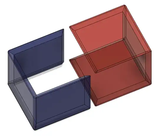

"simple" hollow cube from 2 C-clamps
This is a simple object generated by a mere extrusion, rounding corners, extruding again and a sweep, then copying the item and moving it into position.

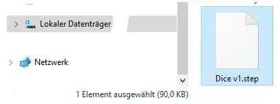

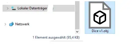

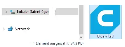

But how does that compare as STL and OBJ? Well, the results of this item are rather small in either case, but you get a rough gist of their general comparability.
The STL is 74.3 kB, STEP is 90 kB, OBJ is 95.4 kB.
STL
STEP
OBJ

  • STEP shrinks by 86 % to 13 kB
  • OBJ by 84 % to 16 kB
  • STL by a mere 73 % to 21 kB.
