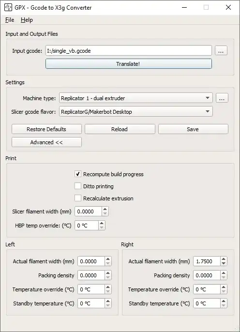

  • finally, I use GPX UI to generate a xxx.x3g file.

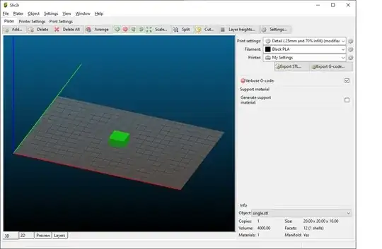

When I drop the object into Slic3r, it goes to middle of build plate.
Slicer Preview

GPX UI

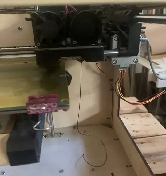

Unfortunately here's what gets printed.
Attempt #1, off in space
print fail #1
Attempt #2, Right Hand Margin
print fail #2
Attempt #3, Near the front.
print #3
I tried moving the print head to center of build plate, thinking that might be a logical start point. No go. Print start moves head to home (rear right corner of print bed) then after elements heat up to temp, it seems to select a random spot on the build plate to start. I never touched the .x3g file between these attempts. So I'm right back to where I started, per the title of this posting "What determines print start location on the build plate?"

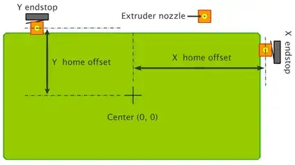

For the MakerBot Replicator (or FastForge Creator) family of 3d printers, the origin of the build plate is NOT at any of the corners, its right in the center of the build plate. Reference here.
4.1 Home Offsets:
By convention, the center of the build platform is assumed to be the point (0,0,0) in XYZ space. The X, Y, and Z home offsets tell the printer the location of the X, Y, and Z endstops in relation to the build platform’s center.
Looks like this:
Center of build plate is origin

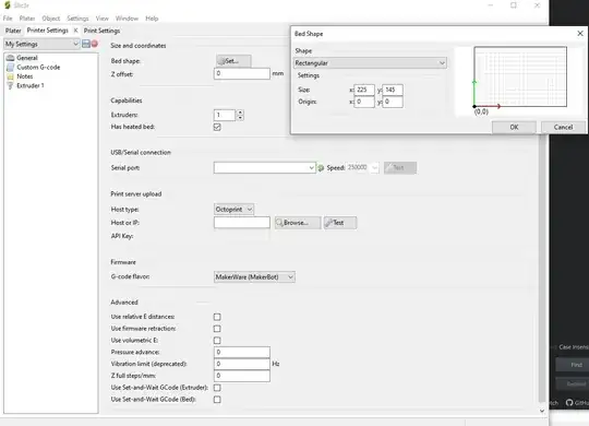

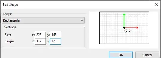

And it would appear that most other 3D printers are not using this convention. Sigh. From my testing, the main control of print location is within the G-Code generated by the slicer. The tool I was using, Slic3r does give one a chance to correct that adjustment. You have to go to top menu Settings --> Printer Settings --> Size and Coordinates (Bed Shape) --> Set to get a nice popup visual tool. See below.
Unfortunately the default setting is accurate for the overall bed size, but is a fail for the origin location on the bed. The default origin is set at 0,0, in the corner. Ouch. Big ouch. The origin needs to be located right in the center of the build plate (to be consistent with the firmware controlling the print for this family of printers). It should look like this:
print bed origin setup

So as long as you understand the quirks of these printers things will work out. You have to ensure offsets are set accurately in firmware config files. (Replicator / Sailfish) And you have to indicate the correct center location to the slicer program. I will say the advice given here was of some help in understanding this. Many thanks. I'm posting here in case others using the Replicator or FastForge Creator series of printers is having troubles centering their prints on the build plate.

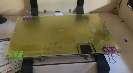

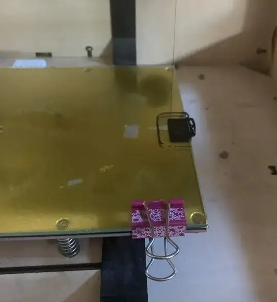

Let's say the build plate has dimensions $a$ and $b$ and the corner with the green clip is $\{0;0;0\}$. The item is sliced to the position $\{a/2 ; b/2\}$ of the bed. It appears at $\{a ; b/2\}$ and $\{a/2 ; b\}$ respectively. This hints that the center of the bed is somehow taken as one of the coordinates.
If the corner without the clip is assumed as $\{0;0;0\}$, then X should be to the right, Y to the front following the right-hand-rule. To see if the coordinates might be skewed, the following command snippet would be useful. Please execute them one by one.
