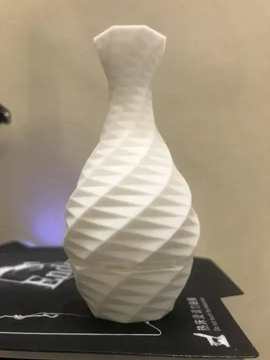

As you can see from the picture, the part is good except some missing layers near the bottom. I have tried to search for this problem but nothing similar appeared. So, what might be the cause and what is the name for this problem?
Photo showing print issue
  • Printer: Ender3, new.
  • Slicer: Cura
  • Nozzle: 0.4 mm
  • Temperature:
    • 200 °C nozzle
    • 50 °C bed
  • Material: PLA
  • Print speed: 50 mm/s

This looks like either the nozzle had been clogged for some layers and it resolved itself or the g-code contained incorrect instructions.
I suggest altering your print settings slightly and reslicing, then just printing it again. To get more accuracy on the prints, I suggest a line width of 0.45 mm.
